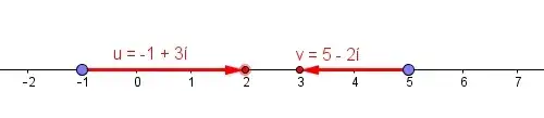

You could represent the complex numbers using arrows on a line. The location of the start of the arrow is the real part, and the length/direction of the arrow is the imaginary part. For example, this picture shows how two numbers -1+3i and 5-2i look in this representation. (A real number is just a dot in its usual place on the line.) complex numbers as arrows
It doesn’t preserve most of the spatial properties of complex numbers like rotation or length, but it still might produce an interesting result.
I don’t know if anyone else has used this method before, so I don’t know if it has a name.
