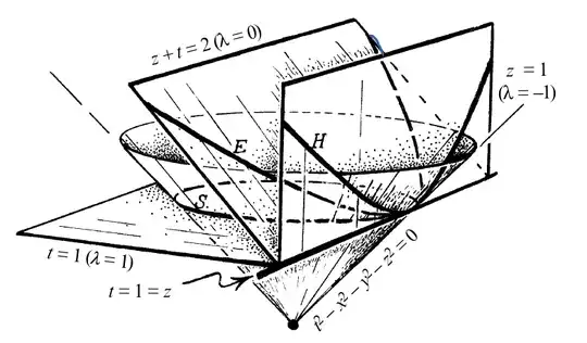

Now, following TRTR from Penrose page 423, we can consider the family of hyperplanes inside $\mathbb{M}^4$ given by $$ z+t+\lambda(t-z)=2 $$ intersecting our cone in different 2-dimensional submanifolds $P_{\lambda}$ of $\mathbb{M}^4$.
Here we have a picture from that book, where we consider only $(x,z,t)$ for purposes of drawability.
If we analyse the case $\lambda=0$, we observe that we obtain the submanifold $P_0$, $E$ in the picture with a shape of a parabola, given by the embedding
\begin{align*} \phi \colon \mathbb{R}^2 &\longrightarrow \mathbb{M}^4\\ (u_1,u_2) &\mapsto (u_1, u_2, 1-\frac{u_1^2+u_2^2}{4},1+\frac{u_1^2+u_2^2}{4}) \end{align*}
We can look for the (possibly pseudo) metric inherited by $P_0$. Since $$ d\phi=\begin{pmatrix} 1 & 0 \\ 0 & 1\\ -\frac{u_1}{2} &-\frac{u_2}{2}\\ \frac{u_1}{2} &\frac{u_2}{2} \end{pmatrix} $$ we conclude that $P_0$ consists of $\mathbb{R}^2$ with the euclidean metric: $$ g=\begin{pmatrix} 1 & 0 \\ 0 & 1\\ \end{pmatrix} $$
That is, although we see it like a parabola, intrinsically is only the Euclidean plane, and that is the reason the latter is sometimes called parabolic geometry.

Next step is to show that for $\lambda>0$ we have an isometry into the usual sphere, and that for $\lambda<0$ we have an isometry into the hyperbolic space. This would justify the terms elliptic and hyperbolic for those geometries, as you can see at the picture above ($S$ and $H$ respectively). In order to keep it simple we can work with $\lambda=1$ and $\lambda=-1$.
