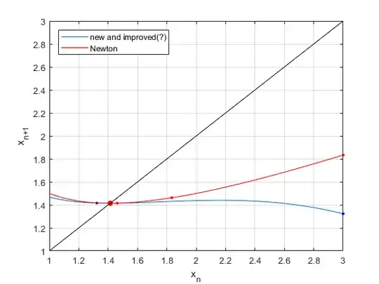

Here's one that converges faster (fewer steps), at least in a certain range:
$x_{n+1}=-{1\over32}x_n^3+{5\over8}x_n+{7\over8}{1\over x_n}$
That has the desired properties of $P(\sqrt 2)=\sqrt 2$ and a local minimum at $x=\sqrt 2$:
It can be seen that the curve (and thus the iterates starting from $x < 3$ anyway) is closer to $\sqrt 2$ than the Newton curve.
The ratio of first seven iterates to $\sqrt 2$, starting from $x=3$:
new&improved      Newton
2.121320343559642 2.121320343559642
0.935443345944703 1.296362432175337
1.001184535464119 1.033875824007604
1.000000349950901 1.000554985146933
1.000000000000031 1.000000153918834
1.000000000000000 1.000000000000012
1.000000000000000 1.000000000000000
Of course, it's only about one step ahead, and there's the additional cost of the cube factor
