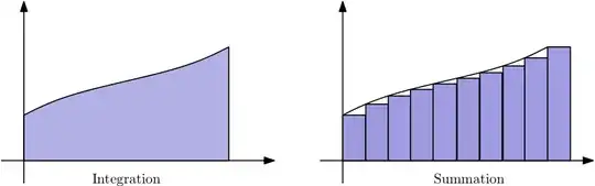

Since a picture says more than words ...
A.Schulz
  • 3,828
    In your summation picture, the center of each rectangle should be on the line. This would demonstrate how the summation end up being a higher value than the integration. – woz Nov 29 '12 at 13:53
