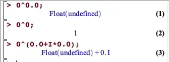

undefined for floating point $0$ in the exponent
Related to the "indeterminate" case. Definition of exponentiation for complex numbers: $a^b = \exp(b\log a)$. This is undefined for $a=b=0$.
Perhaps the confusing thing is using the same symbol $0$ for all those different things!
Here is Maple's opinion:
