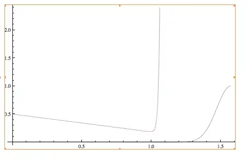

So here's what I did:
First, this graph would be a train of highly sharp peaks. The integrand would assume values close to zero a up till before it sharply rises to 1.
So up till some $\epsilon \in [0,\pi/2]$ we will have $\sin x \approx x$ and for the remaining $\pi/2 - \epsilon$ interval I could find the area of triangle with base $\pi/2 - \epsilon$ and height $1$
$$\langle \sin^{100} (x)\rangle \approx \frac{2}{\pi} \left(\int_0^\epsilon x^{100} dx + .5 (\frac{\pi}{2}-\epsilon)\right).$$
I believe in principal it should be possible to find an $\epsilon$ such that the above expression yields the exact answer. So I try to approximate it, no good. Then I try mathematica and it is looking like there is no $\epsilon$ for which the value I am expecting is even close to the actual value. I plot the original and find that my approximation is hopeless.
Not to mention that my 5 minutes were over. So I admit I do not understand mathematics and humbly ask if someone could:
  1. Point out my mistake (Other than that $\epsilon$ is probably incomputable within 5 mins)
  2. How the hell is this done in 5 minutes?enter image description here
The picture below has the $\sin^{100} x$ in blue (bottom) and my approximation of it plotted against $\epsilon$ (pink). Although there is no reason for them to be together, the upper graph has a minima quite above the exact value of the integral.
