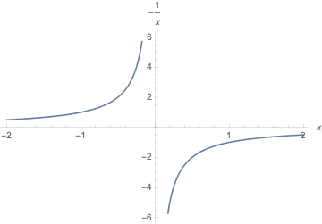

Another interesting example is when $V=-\frac{1}{x}$ which is plotted below:enter image description here
If you imagine a ball being rolled from $x<0$ it would need infinite kinetic energy to get to $x>0$. However, we expect some new physics to come in and keep $V$ finite and continuous around $V=0$. In that case the difference in potential energy between $x=-1$ and $x=1$ would simply be $V(-1)-V(1)=2$. So we would want $$ W=-\int_{-1}^1 \frac{1}{x^2}\,dx=2 $$ As explained in this answer, for this case the Cauchy principle value for the integral gives $-\infty$ while contour integration gives $2$. So in this case, contour integration is better than Cauchy's principle value from a physics perspective.
