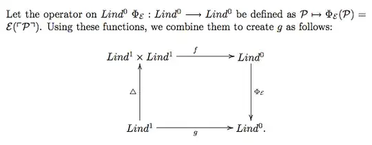

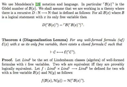

I've read through this paper with applications of Lawvere's fixed point theorem. On the diagonalization lemma, they say the following:
For one thing, how can $f$ and $\Phi_{\cal E}$ be well defined maps? As far as I understand, the Lindenbaum algebras contain all FO formulas in the language of some theory $S$, modulo $S$-equivalence (logical equivalence proveable from $S$). And this also makes sense, since the fixed point we ought to find is only fixed modulo $S$-equivalence, but I don't see $f$ and $\Phi_{\cal E}$ factorizing through $S$-equivalence.
Also, am I right to interpret the arrows here not as algebra homomorphisms but set functions?
Here's what I've tried so far to save the proof:
  • First I define $\ulcorner\phi\urcorner_S$ to be the smallest number $n$ such that $S\vdash\phi\longleftrightarrow\llcorner n\lrcorner$
  • Then I show that the diagonalization lemma $\forall{\cal E}\in\text{Lind}^1_S.\exists{\cal C}\in\text{Lind}^0_S.S\vdash{\cal C}\longleftrightarrow{\cal E}(\ulcorner{\cal C}\urcorner)$ is weaker than its variant using $\ulcorner\cdot\urcorner_S$ instead of $\ulcorner\cdot\urcorner$.
  • I define $f'$ and $\Phi'_{\cal E}$ as the $\ulcorner\cdot\urcorner_S$-variants of $f$ and $\Phi_{\cal E}$ respectively.
  • Then I show that $f'$ and $\Phi'_{\cal E}$ factorize through $S$-equivalence and that $\Phi'_{\cal E}\circ f'\circ\Delta$ can be encoded over $f'$, i.e. there exists $[\phi]\in\text{Lind}^1_S$ such that $\Phi'_{\cal E}\circ f'\circ\Delta=f'\circ({\sf id}\times{\sf c}_{[\phi]})$ (where ${\sf c}_x$ denotes the constant map to $x$).
At this point I can safely apply Lawvere's fixed point theorem to get the $\ulcorner\cdot\urcorner_S$- variant of Godel's diagonalization lemma.

  • As far as I can tell, you are correct that $f$ and $\Phi_\mathcal{E}$ are not well-defined functions. – Derek Elkins left SE Sep 19 '17 at 09:10
  • The non category theory was of doing this is to define $S(,)$ as
    $$S(\ulcorner P() \lrcorner,~ x) = \ulcorner P(x) \lrcorner$$ (only defined for a predicate $A$ with a single free variable), and $B()$ as
    $$B(x) = A(S(x, x))$$
    Then $D = B(\ulcorner B(x) \lrcorner) = A(S(\ulcorner B(x) \lrcorner, \ulcorner B(x) \lrcorner) = A(\ulcorner B(\ulcorner B(x) \lrcorner) \lrcorner) = A(\ulcorner D \lrcorner)$
    $$ $$ Your $f(x, y)$ is $S(y, x)$
    – DanielV Sep 19 '17 at 13:29
