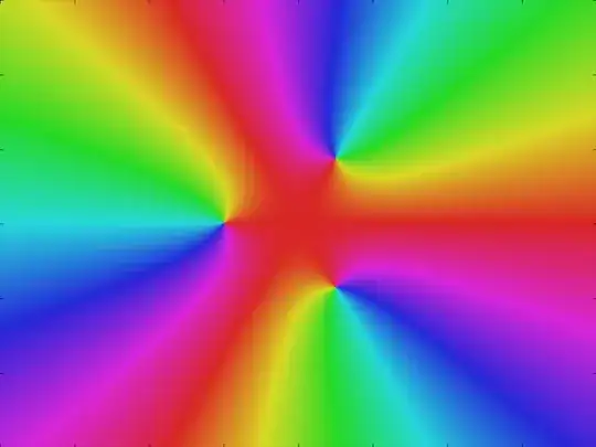

For instance, $f(z)=z^3+1$. This is how looks the interval $z=[+/-]4+[+/-]3i$:

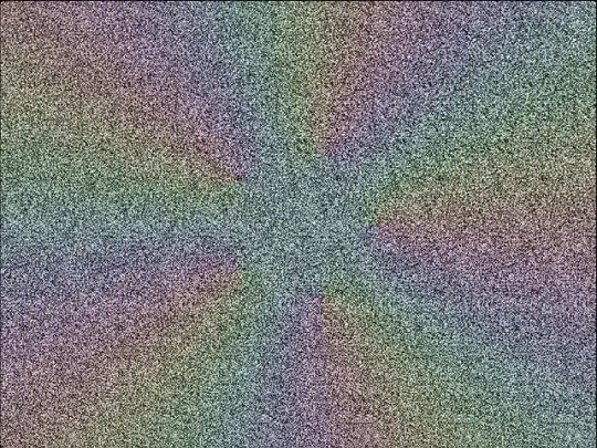

So far so good. But we cannot perceive the sense of depth. So what I want to do is bringing up that depth using autostereograms.

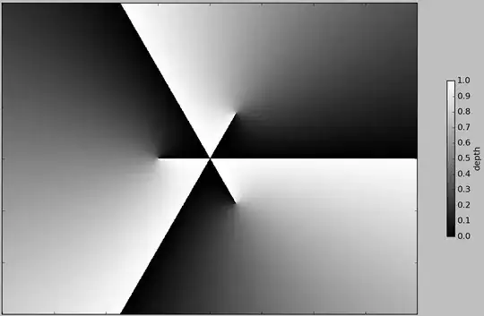

My first idea was applying directly the normalized color map as depth map, and then create the autostereogram. The normalized color map shown above is converted into the following depth map:

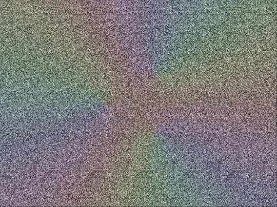

And then it is possible to create the autostereogram. It is of the "wall-eyed" ("parallel") convergence type (non-cross eyed). The three-dimensional effect can be produced by both eyes looking at a the image by defocusing the eyes at a certain distance. The examples are fine-tuned to be seen at a distance around $30-40$cm (click in the image to see a full screen view):
There is a trick: it is included a subtle layer with the original color map, and then added transparency to the autostereogram (alpha=0.9). In that way, the original color map can be slightly seen and works as a color texture over the autostereogram, so when we look at it, we can see that colors and depth are matching.

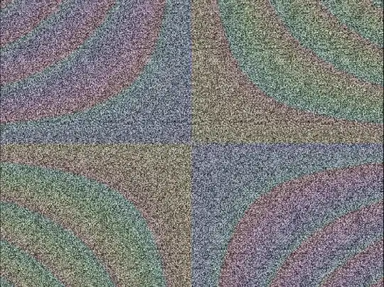

Two more examples: $f(z)=z^5-1$ and $f(a+bi)=\tan{(ab)}+atan(ab)i$:
Indeed it is possible to make also animations once the eye gets used to the correct focal length.

    Hello, your stereograms are not very good. It is because of too wide separation. To view your stereogram eyes have to be not parallel but almost turned outwards (opposite of cross-eyed). It is tiresome for eyes. I suggest to use smaller separation. – azerbajdzan Nov 20 '18 at 15:37
  • @azerbajdzan thanks for the feedback, curiously in my case, staying at 50-60cm is fine, so probably it depends on the person. Just in case: if you use glasses (like in my case), for instance for myopia, you need to remove them before looking at the images. The adjustments of the glasses also vary the distance required to watch the images. Have a nice day! – iadvd Nov 21 '18 at 00:32
