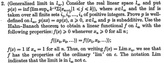

I am trying to solve the following problem (found in Maddox's book "Elements of Functional Analysis", page 128):
So we have the function $p:l_\infty\rightarrow\mathbb{R}$ given by

Now I just have to show that $f$ satisfies the conditions given by the problem, which are:
  1. $f(x)=1$ if $x_n= 1$ for all $n$
  2. $f(x)\geq 0$ if $x_n\geq 0$ for all $n$
  3. $f((x_2,x_3,\ldots))=f((x_1,x_2,\ldots))$
