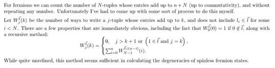

I'd like to try to develop some formal maths for listing the degeneracies of spinless fermion states in a harmonic oscillator. For those who don't know much quantum physics, I'm essentially trying to count the number distinct k-tuples whose entries sum to some number n (up to commutativity, ie. (123) = (213) = (312) = (321)), as well as adding the restriction that no two numbers in this k-tuple can be repeated.
Number of ways to write n as a sum of k nonnegative integers
The post in the link above helped me with the case of bosons (the same deal, but no repetition restrictions). I'm hoping someone could help me out, as I started to develop a flawed formalism and I'm too motivated to stop now. If you test the case j=3, k=3, you obtain 2 ways to write the j-tuple: (210) and (012), but these are just the same in my terms. Thanks a lot! Flawed maths
hardmath
  • 37,715
I presume zero cannot be repeated. Denote the number of partitions $(p_1,\ldots,p_k)$ with $p_1>p_2>\cdots>p_k\ge0$ and $\sum_i p_i=n$ by $a_{n,k}$. We can express the $a_{n,k}$ as the coefficients of a generating function $$\sum_{n,k}a_{n,k}x^nt^k=\prod_{m=0}^\infty(1+x^m t).$$ To see this, note that the terms in the product involving $t^k$ are $x^{p_1+p_2+\cdots+p_k}t^k$ with $p_1>\cdots>p_k$. I'm not sure what one can do with this. You could rewrite it like $$\sum_{n,k}a_{n,k}x^nt^k=\prod_{m=0}^\infty\frac{1-x^{2m}t^2}{1-x^m t}.$$ (This kind of manipulation is occasionally useful in partition theory.)
