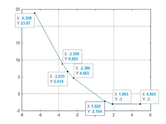

The above is a Piece Wise linear function of $ \mu $.
Since the function is continuous yet it is not differentiable due to its piece wise property theory says we must use derivative free methods for root finding. One could use the Bisection Method for instance.

If we look at the values of the function $ h \left( \mu \right) = \sum_{i = 1}^{n} { \left( {y}_{i} - \mu \right) }_{+} - 1 $ one could easily infer a method to calculate the accurate solution:
In the above the parameter $ \mu $ took the values of the vector $ {y}_{i} $ with additional values at the edges (Value greater than the max value of $ {y}_{i} $ and value lower of the min value of $ {y}_{i} $).
By iterating the values one could easily track the 2 values which on each side they have value greater than $ 0 $ and lower then $ 0 $ (In case one of them is zero, then it is the optimal value of $ \mu $). Since it is linear function and we have 2 points we can infer all parameters of the model $ y = a x + b $. Than the optimal value of $ \hat{\mu} = - \frac{b}{a} $.
