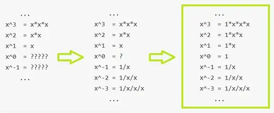

There are good answers on this question but a visual representation of pow function may be useful too.
Please, consider this patterns
x^3  = x*x*x
x^2  = x*x
x^1  = x
x^0  = ?????
x^-1 = ?????
x^3 = 1xxx x^2 = 1xx x^1 = 1x x^0 = 1 x^-1 = 1/x x^-2 = 1/x/x x^-3 = 1/x/x/x ...
A simple traditional definition of pow function means how many times we multiply a number by self.
But in more strict sense pow function means how many times we multiply or divide the one by a number.
By this reason x^0 = 1 => 0^0 = (-1)^0 = 1 too.
x^0 = 1
In a more general case the seed may be any number.
