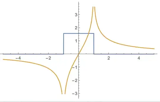

In term of distributions, the Fourier transform of $\frac{\sin(\pi x)}{\pi x}$ is $1_{|\xi| < 1/2}$ and the FT of $1_{x > 0}$ is $\frac{1}{2i \pi}\frac{d}{d\xi} \log |\xi| + \frac{1}{2} \delta(\xi) $,
thus the FT of $\frac{\sin(\pi x)}{\pi x}1_{x > 0}$ is $$1_{|\xi| < 1/2} \ast (\frac{1}{2i \pi}\frac{d}{d\xi} \log |\xi| + \frac{1}{2} \delta(\xi)) = \frac{\log|\xi + 1/2| - \log|\xi - 1/2| }{2i \pi}+ \frac{1_{|\xi| < 1/2} }{2}$$

  • @MarkViola Right, I answered to the title, the Fourier transform. Also for $\Im(t) > 0$ instead of Frullani theorem you can integrate $\int_0^\infty \sin(x) e^{-sx}dx$, which is what suggests what he wrote about $\arctan$ ? – reuns Aug 02 '17 at 20:01
  • If you want to adapt my answer, then the FT of $e^{-\sigma x}1_{x > 0}$ is $\frac{1}{\sigma+2i \pi \xi}$ and the result (up to $\omega = 2i \pi \xi$) is $1_{|\xi| < 1/2} \ast \frac{1}{\sigma+2i \pi \xi} = \arctan \ldots$. So I still think the term $\frac{1_{|\xi| < 1/2}}{2}$ appears from the branch of $\arctan$ – reuns Aug 02 '17 at 20:04
