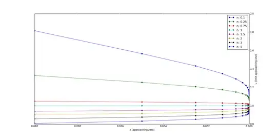

With simulations using different values of $n$, I get convergence to $1$.
