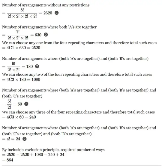

suppose we have two blue balls (AA), two red balls (BB), two green balls (CC) and two yellow balls (DD). Then we have the following way of obtaining the answer. This method uses inclusion-exclusion.
Note: generated using Permutations Calculator
Kiran
  • 4,353
