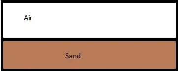

Here is how I think of this intuitively; this is not mathematically rigorous, and so might not be the best answer to your question, but I suppose it's worth trying. Assume we have a box that is half filled with sand:
At each point on the boundary between the air and the sand, there are both particles of sand and particles of air. Can we use this information to measure the amount of sand compared to the amount of air in the box? This depends a lot on what you mean by the "amount." Both the air and the sand do equally well at covering the boundary. But what if weighed the air and the box, and then weighed the sand? The sand would be much heavier because it's physical density is higher. In this sense, the property that both materials cover the boundary is useless; we have to use completely different tools to measure the weight of the air and the weight of the sand.
In my head I think of the air as the rationals and the sand as the irrationals. Both numbers are equally useful in "approximating the boundary;" i.e. both sets of numbers are dense in $\mathbb{R}$. However, to measure the "weight," or countability, of the two sets, we have to use other methods.
