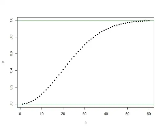

Maybe you gave up on the birthday problem too quickly. If you divide the audience up into groups of 50 (probability .97) then almost every group will have one or more birthday matches; (and probability .994 for group of 60). Intuitively, it seems to me almost as unlikely to get a match among 50 as among 23. [Computation below from R statistical software.]
n = 1:60;  p = numeric(60)
for (i in n) {
  q = prod(1 - (0:(i-1))/365)
  p[i] = 1-q }
plot(n, p, pch=20);  abline(h=0:1, col="darkgreen")
p[n==23]; p[n==50]; p[n==60]
## 0.5072972  # just over 1/2 for 23 people
## 0.9703736  # above 97% for 50
## 0.9941227  # almost sure for 60
Why do people misjudge the probability? (a) Thinking of the probability their own birthday will be matched, but there are ${n \choose 2}$ pairs of people that might have a match. (b) It would take 366 people (ignoring Feb 29) to be absolutely sure of a match and 50 is a long way from 366, but the probability does not increase linearly (as shown in the graph).
Notes: (a) The model is not exactly right because in the US there are more births in late summer than in winter. However, simulation studies with unequal birth frequencies as in the US show very little change from the theoretical values (and the change is to increase the probability by a little). There is of course a breakdown point. You wouldn't want to try this at a convention of twins or at a meeting of the Sagittarian Society; then obviously you'd get matches.
(b) One can also find the expected numbers of birthday matches; mean about 0.8 in a group of 23. I could estimate it for a group of 50, if you like. (Three people born on 7/4 counts as two matches.)
(c) How for a group of 50 to determine quickly if it has matches? Start by finding matches in Jan, Feb, etc. Then check for exact days within those groups. I have tried it in a class of about 50 without chaos.

  • In a million simulated groups of 50, assuming equally likely birthdays, the average number of birthday matches was $3.213 \pm 0.003$ per group. – BruceET Jun 29 '17 at 00:43
  • Interesting! So with an expected 3.2 matches per group, that could mean a pretty high confidence level of 3.2x40 (groups) = 128 birthday matches in a crowd of 2,000. Since I'm going for impressive numbers here, instead of "matches" if I say "individuals who share a birthday with anyone in their group" (IWSBWAIG), any idea what the expected outcome would be? ~x2 # of matches? And is there an ideal group size (even by testing just in increments of 10) such that IWSBWSIG results in an overall higher number after multiplying by # of groups from pool of 2000? Hopefully my phrasing isn't confusing. – Benny Lewis Jun 29 '17 at 01:02
  • There are at least two people involved in each match. There are lots of birthday matching Q&As on this site. As I recall one of them found a combinatorial formula for the number of people involved in matches. // I think you need to choose group sizes you think will be manageable. I don't immediately see an optimal size based on a statistical argument, if I understand your intent. – BruceET Jun 29 '17 at 01:08
    For 2000 people I got over 1630 matches. There are only 365 unique birthdays to go around. After you've accounted for those everyone else has a match. (Also remember if $k + 1$ people have the same birthday that counts as $k$ matches.) // Whatever you decide to do, I wish you great success with your talk! – BruceET Jun 29 '17 at 01:31
  • Tversky has lots of interesting examples on how people make irrational probability assessments. Recent reference. – BruceET Jun 29 '17 at 02:23
  • Going with this example - the visualization on that curve helps especially. Thanks again! – Benny Lewis Jul 01 '17 at 12:22

  • Birthday redux with 60 people might work very nicely. (+1) – BruceET Jun 29 '17 at 08:48
  • @BruceET, thanks. Is there a particular reason you are suggesting 60 people? I was trying to minimise the number of people (already 46 will be cumbersome to handle) and the need for some certainty. I went for 46 (and 95% probability). We could go down to 40 (giving us 89%), but I think 95% sounds better costing us just 6 people more. 60 people would give us 99.4% certainty, which I think is needlessly high. Did you have another criterion in mind? Maybe multiple matches? – Thanassis Jun 29 '17 at 09:01
  • Just cautiously going for the 'needlessly high' probability. If 40 are manageable, why not 60? I have had failures with 40, quite possibly because not everyone can hear the birthdays being announced or is paying attention. – BruceET Jun 29 '17 at 09:08
  • @BruceET Sure it's not a huge step up, but my personal preference would be to keep the number of people on stage as low as possible. I have worked with facilitating groups of people (in theatrical activities) and there is a big different between 30 people and 60 people. Not exactly our situation, but I would take the 5% risk, for the benefit of fewer people. I guess the OP will have to decide what they feel comfortable with. – Thanassis Jun 29 '17 at 09:18
