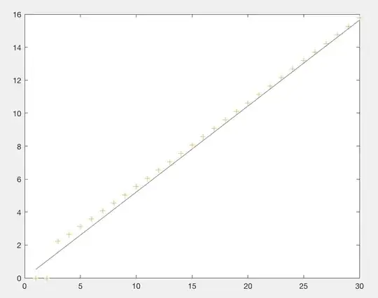

After doing some MatLab simulations, it appears that this is a pretty good approximation, as shown in the picture below (the purple line is the asymptotic value $n\cdot \gamma$, and the yellow $+$'s are the actual averages computed using a very similar code to the one I used above to compute the values of $C_n$).

    Brilliant, I like this approach a lot, haha nice mapping of the problem to different known results. You are right in your 3 given conditions, indeed my single Eq was actually not exactly correct, I will fix this in the post too. Maybe we can find a way to use our knowledge of $C_n$ and come up with a correction for our last estimate. – user929304 Jun 15 '17 at 20:05
