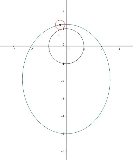

Is this parameterisation an ellipse: \begin{align}x(t) &= \frac{2 \cos(t)}{1 + a \sin(t)}\\ y(t) &= \frac{2 \sin(t)}{1 + a \sin(t)}\end{align} where $a$ is a real positive parameter.
I tried to do it the naive way but couldn't find a definitive answer.
Plotting our curve with the help of Geogebra gives the following very ellipse like graph:
Plotting our curve with the help of Geogebra gives the following very ellipse like graph.
Any help would be appreciated.
  • Nice picture. I think it's unlikely to be an ellipse. You probably want $a < 1$ to avoid a $0$ in the denominator. – Ethan Bolker Jun 12 '17 at 14:43
    Using your parameterisation, can you form $x^2(t)+y^2(t)$? If so, does that look like the cartesian equation of an ellipse? –  Jun 12 '17 at 14:44
    Welcome to StackExchange! When you say you tried the naive way, what exactly do you mean? Showing your working my help people point out if you have gone wrong or help you understand things you are confused about – lioness99a Jun 12 '17 at 14:44
  • We formed x(t)^2+y(t)^2 but didn't think of eliminating t.. However the problem is now settled. Thank you guys! – Richard Kruel Jun 12 '17 at 15:09
    An explanation of the diagram would be nice. What are the green, red, and black curves? What is $a$? – TonyK Jun 13 '17 at 13:45
    @RichardKruel Be sure to accept an answer below if it answered your question. – Bonnaduck Jun 13 '17 at 17:22
