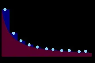

This doesn't make sense to me. The two values subtracted appear to be equal: How does $$\psi(z+1)=\psi(z)+\frac{1}{z}\tag{2}$$ differ from $\sum_1^n \frac{1}{z}=H_n$ If the sum in (2) doesn't terminate at 1, the definition of the sum is undefined for gamma at negative integer values. If wikipedia is saying non integer values of $\Psi$ of a finite sum i.e. $\frac{1}{1.5}+\frac{1}{2.5}+\frac{1}{3.5}\dots$ differ from $H_n$ by $\gamma$ I'm equally doubtful as $\gamma$ is only equal to infinite sums and I don't see how this value could equal the infinite difference between the integral and sum $\frac{1}{n}$. What am I not understanding. Please help. enter image description here
Edit: as noted in the comments, could someone explain/link/prove why $\frac{\Gamma'(0)}{\Gamma(0)}=\gamma$
