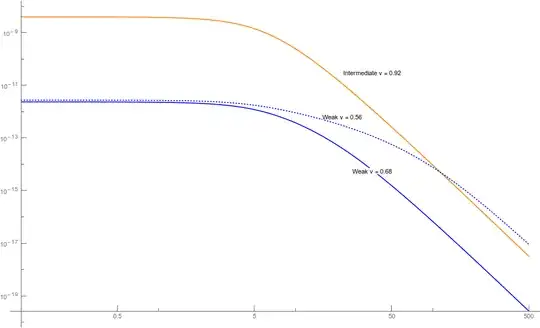

Now, I've got the solution and its dependence on the parameters, but it's extraordinarily ugly (it's about two pages long, so I won't include it here!). Furthermore, this is just the start of a bunch of complicated calculations I'll have to perform, and so breaking it up into some manageable chunks of some form would be very helpful. I'm mainly interested in the "small" and "large" regimes, as well as where the function "changes" the overall power law. For example, in the following Log-Log plot, you see there is a "knee" around the region of "5" to "10", at different points for different parameters of the problem.
Log Log Plots

1) Does anyone have any ideas on how to break this up into a more manageable function say, using a Taylor Series? An earlier study showed that it sort of went as $$\sim \frac{1}{1 + c_1 k^2 + c_2 k^5}$$ but in that case the integral was enormously simpler (it still needed to be approximated by manipulating $c_1$ and $c_2$ though) and there were no parameters like $a$ and $b$ involved.
I can get rid of one of the parameters by rescaling the variable but I'm still left with another. I can then do a Taylor series approximation around $0$ to get the leading order terms, and another around $\infty$ to get the asymptotic dependence. However, in the intermediate region I'm basically working in the dark.
2) Can the Taylor series around some pivotal point could help me in approximating the function in this region. I can easily perform such a series, but it gives me results in powers of $(k-k_0)$, which work locally, but not globally (i.e. I couldn't just "attach" it to the other initial and asymptotic values.
3) Furthermore, if I "knew" there should be (say) a $k^{-1}$ behaviour around a certain point (say $k_0$), would I be able to verify this using a Taylor series? Would I be able to get it's coefficient somehow?
I'm sorry if these seem like evident questions, I really feel like I ought to know the answers (or atleast if it's possible!), given how much I've used these series in Physics! I'd really appreciate any help, I've wasted an insane amount of time on this, but I can't move forward without even a roughly analytic form of the graph.
