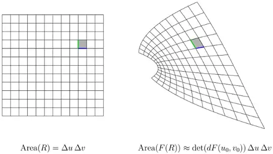

To give a geometric interpretation: Suppose you apply a linear change of variables $(x, y) = T(u, v)$ to the plane: $$ \begin{aligned} x &= au + bv, \\ y &= cu + dv; \end{aligned} \quad\text{i.e.,}\qquad \left[\begin{array}{c} x \\ y \\ \end{array}\right] = \left[\begin{array}{cc} a & b \\ c & d \\ \end{array}\right] \left[\begin{array}{c} u \\ v \\ \end{array}\right]. $$ Since $T$ is linear, $T = dT(u_{0}, v_{0})$ for every point $(u_{0}, v_{0})$.
The oriented rectangle $[u_{0}, u_{0} + \Delta u] \times [v_{0}, v_{0} + \Delta v]$, which has signed area $\Delta u\, \Delta v$, maps to a parallelogram whose signed area is, from linear algebra, $$ (ad - bc)\, \Delta u\, \Delta v = \det(dT(u_{0}, v_{0}))\, \Delta u\, \Delta v. $$
If instead your change of variables $(x, y) = F(u, v)$ is continuously-differentiable, the preceding discussion still holds "approximately at small scales": The oriented rectangle $[u_{0}, u_{0} + \Delta u] \times [v_{0}, v_{0} + \Delta v]$ at left maps to a near-parallelogram at right whose signed area is $$ \Area(F(R)) = \det(dF(u_{0}, v_{0}))\, \Delta u\, \Delta v + \text{error}, $$ with error asymptotically small in absolute value compared to $\Delta u\, \Delta v$. Using infinitesimal notation, this state of affairs may be expressed by saying $$ \Area\bigl(F([u_{0} + du] \times [v_{0} + dv])\bigr) = \det dF(u_{0}, v_{0})\, du\, dv. $$
To connect this with integration, let $D$ denote the oriented rectangle on the left, think of a continuous, real-valued function $f$ defined over the region $F(D)$ on the right, and consider the problem of expressing the integral as an integral over $D$ itself. The change of variables formula says (assuming $F$ is one-to-one) $$ \iint_{F(D)} f(x, y)\, dx\, dy = \iint_{D} f(F(u, v)) \det dF(u, v)\, du\, dv. $$ This is the sum of infinitesimal contributions of the type \begin{align*} \iint_{F(R)} f(x_{0}, y_{0})\, dx\, dy &= f(F(u_{0}, v_{0})) \Area(F(R)) \\ &= f(F(u_{0}, v_{0})) \det dF(u, v) \Area(R) \\ &= \iint_{R} f(F(u_{0}, v_{0})) \det dF(u, v)\, du\, dv. \end{align*} (If $R$ is sufficiently small, the continuous functions $f$ and $f \circ F$ are nearly constant.)
