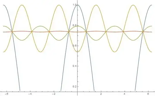

Evaluating $\lim\limits_{n\to \infty} I_n$:
I realized that as $n\to \infty$, the integrand will converge to a constant function for all $x\in \mathbb{R}$, as shown below. The blue, yellow, green and red curves is when $n=1,2,5,10$ respectively.
I figured that we can represent the repeated composition of functions by the following recurrence $x_{n+1}=\cos(x_n)$. Using the principles of fixed point iteration, we know thus know that the value it tends to is the unique solution to $x=\cos(x)$. This turns out to be the Dottie Number, which I evaluated numerically using the Newton-Raphson Method and denoted this value by $\alpha$. I obtained: $$\alpha\approx 0.739085133215161$$ Hence: $$\lim_{n\to \infty} I_n=\int_0^{\pi/2}\cos(\cos(\cos(\dots(\cos(x))\dots)))~dx=\alpha\cdot \frac{\pi}{2} \approx 1.160952212443092$$
