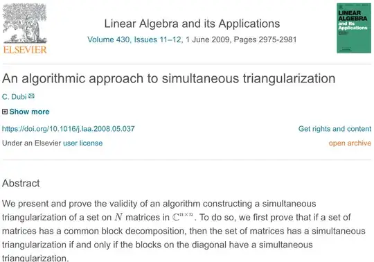

If you need more information check out the algorithm in the paper by Dubi:
