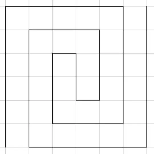

Your solution looks fine. However you might want a constructive solution:
Here the curve has constant "speed" $1$.

  • I don't understand this image. – Janitha357 May 22 '17 at 14:09
    @Janitha357: let $f(0)$ land on any grid point, $f(1)$ the grid point 1 away along the curve in some direction, and so on. This is a continuous map $f: \mathbb{R} \to \mathbb{R}^2$. – Joppy May 22 '17 at 14:51
