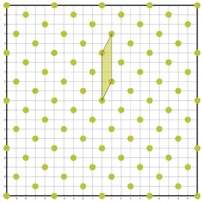

The way I think about a lattice is as an array of points. The lattice is specified by a set of basis vectors. For example a 2D lattice can be defined by the following basis:
$$\mathcal{B} = \begin{bmatrix} \hat{e}_x & \hat{e}_y \end{bmatrix} \Lambda = \begin{bmatrix} \hat{e}_x & \hat{e}_y \end{bmatrix} \begin{bmatrix} 1 & 0 \\ 2 & 5 \end{bmatrix} = \begin{bmatrix} \vec{b}_x & \vec{b}_y \end{bmatrix} $$
The lattice consists of all the points that can be expressed as integer linear combinations of the basis vectors: $l\vec{b}_x + m \vec{b}_y$, where $l,m \in \mathbb{Z}$. The lattice generated by the basis vectors $\vec{b}_x = \hat{e}_x + 2 \hat{e}_y$ and $\vec{b}_y = 5 \hat{e}_y$ is shown below.

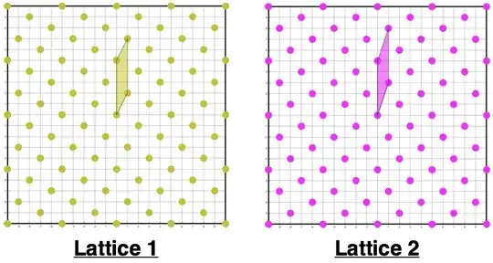

Now suppose I am given two lattices with basis vectors as follows:
  1. $\mathcal{B}_1 = \begin{bmatrix} \hat{e}_x & \hat{e}_y \end{bmatrix} \Lambda_1 = \begin{bmatrix} \hat{e}_x & \hat{e}_y \end{bmatrix} \begin{bmatrix} 1 & 0 \\ 2 & 5 \end{bmatrix}$ and
  2. $\mathcal{B}_2 = \begin{bmatrix} \hat{e}_x & \hat{e}_y \end{bmatrix} \Lambda_2 = \begin{bmatrix} \hat{e}_x & \hat{e}_y \end{bmatrix} \begin{bmatrix} 1 & 0 \\ 3 & 5 \end{bmatrix}$.
The two lattices are shown next to each other.
I want to determine if Lattice 2 is related to Lattice 1 by a simple rotation other than the identity operation. I perform a few checks first:

In the above example, I know visually that the two lattices are related to each other by a rotation operation. However, I am not sure how to solve it using a code of some sort. The complication I think comes from the fact that any lattice has infinitely-many bases.
