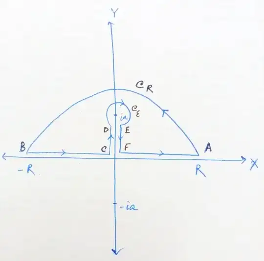

I want to evaluate the integral
$\int_{-\infty}^\infty \frac{\cos{(kx)}}{\sqrt{x^2+a^2}}dx$,
where $k$ and $a$ are constants. Clearly the integrand has two branch points at $\pm ia$. Let $f(z)=Re (\frac{e^{ikz}}{\sqrt{z^2+a^2}})$. Considering the upper half plane, let us integrate along the contour $\Gamma$, which is $AC_{R}BCDC_{\epsilon}EFA$ (see the plot). Plot of the contour over which the integration will be performed Here, $C_R$ is the semicircle of radius $R$ and $C_\epsilon$ is the circle of radius $\epsilon$. Now by Cauchy's integral theorem, \begin{eqnarray} \int_\Gamma f(z)dz=0 \nonumber\\ \left(\int_{AC_RB}+\int_{BC}+\int_{CD}+\int_{DC_\epsilon E}+\int_{EF}+\int_{FA}\right) f(z)dz=0 \end{eqnarray} Let us now take the limit as $R \to \infty$, $\epsilon \to 0$, then first and fourth integrals are zero. Second and sixth integrals will give $2 \int_0^\infty \frac{\cos{kx}}{\sqrt{x^2+a^2}}dx$. So, now we need to integrate the third and fifth integrals whose values will contribute in this integration. Here, I'm stuck. I don't understand what will be the value of z in $CD$ or $EF$ path.

  • @AninditaBera Anindita, in the contour that you used, and with the branch cuts chosen as they are, the term $\sqrt{x^2+a^2}$ is of opposite signs on the positive and negative real axes. The integrals on the contours $EF$ and $CD$ are purely imaginary, so upon taking the real parts, contribute $0$. So, what you end up showing, is $0=0$. – Mark Viola May 03 '17 at 14:39

The OP edited the question and provided a specific contour over which to proceed. We now analyze the integral over the given contour.
First note that the OP assumed that $a>0$. We will proceed under that assumption.
If we choose to cut the plane with branch cuts from $ia$ to $-i\infty$ and $-ia$ to $-i\infty$, then on the positive real axis $\sqrt{z^2+a^2}=\sqrt{x^2+a^2}$, while on the negative real axis, $\sqrt{z^2+a^2}=-\sqrt{x^2+a^2}$. Hence, this reveals
$$\begin{align} \int_{\text{BC}}\frac{e^{ikz}}{\sqrt{z^2+a^2}}\,dz+\int_{\text{FA}}\frac{e^{ikz}}{\sqrt{z^2+a^2}}\,dz&=\int_{-R}^\epsilon\frac{e^{ikx}}{-\sqrt{x^2+a^2}}\,dx+\int_{\epsilon}^R\frac{e^{ikx}}{\sqrt{x^2+a^2}}\,dx\\\\ &=2i\int_\epsilon^R \frac{\sin(kx)}{\sqrt{x^2+a^2}}\,dx\tag 3 \end{align}$$
The sum of the integrals along $CD$ and $EF$ is given by
$$\begin{align} \int_{\text{CD}}\frac{e^{ikz}}{\sqrt{z^2+a^2}}\,dz+\int_{\text{DF}}\frac{e^{ikz}}{\sqrt{z^2+a^2}}\,dz&=\int_{0}^{a-\epsilon}\frac{e^{-ky}}{-\sqrt{-y^2+a^2}}\,i\,dy+\int_{a-\epsilon}^0\frac{e^{-ky}}{\sqrt{-y^2+a^2}}\,i\,dy\\\\ &=-2i\int_0^{a-\epsilon} \frac{e^{-ky}}{\sqrt{a^2-y^2}}\,dy\tag 4 \end{align}$$
Using $(3)$ and $(4)$, and letting $R\to \infty$ and $\epsilon\to 0$ reveals (after taking Imaginary Parts)
$$\begin{align} \int_0^\infty \frac{\sin(kx)}{\sqrt{x^2+a^2}}\,dx&=\int_0^a \frac{e^{-kx}}{\sqrt{a^2-x^2}}\,dx\\\\ &=\frac \pi 2\left(I_0(k|a|)+L_0(k|a|)\right) \end{align}$$
for $a>0$, where $I_0(x)$ and $L_0(x)$ are the Modified Bessel Function of the First Kind and Zero Order and the Modified Struve Function of Zero Order, respectively.
Note that the choice of contour as given in the OP, does not provide any insight regarding the integral of interest $\int_{-\infty}^\infty\frac{\cos(kx)}{\sqrt{x^2+a^2}}\,dx$.

  • @Dr.MV Thanks for your effort. I have rewritten the problem. In your calculation of line 2 to 3, please tell me which path you are integrating there as you have considered the Cauchy's integral Theorem. What is the substitution of $z$ in that path? Also from line 3 to 4, you have taken the substitution x by cosh(x). Then how can be the lower limit zero after the substitution? – Anindita Bera May 03 '17 at 09:11
  • @Nick Thank you very much. I have rewritten the problem. Please have a look on it. – Anindita Bera May 03 '17 at 09:15
  • @AninditaBera Yes, I had a typographical error that has been edited. In the edit, I've added notes to explain the contour deformation. – Mark Viola May 03 '17 at 14:02
  • @Dr.MV Thanks for the explanation. Now I understand that the contour that I'm taking here will give zero value of the integration. The way you have considered (this is the right way to solve this integration), the contour will give twice of modified Bessel function of second kind. It will be very helpful if you provide the plot of contour that you have mentioned in "note" form. – Anindita Bera May 03 '17 at 18:30
  • @AninditaBera I don't have a tool to plot the contour. I have given a detailed explanation in the "NOTES" section of the edit. -Mark – Mark Viola May 03 '17 at 18:43
