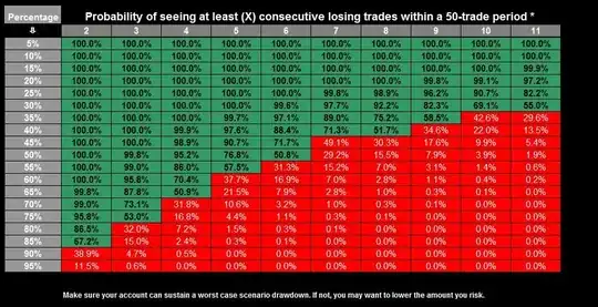

I am trying to figure out the formula used to calculate the numbers of the spreadsheet that I just posted.
To summarize, it is the probability of seeing at least (X) consecutive losing trades within a 50-trade period, given a list of defined winning percentages.
I want the formula/model to solve this so I am able to calculate the probabilities with variables of different values.
Example, the probability of seeing at least 15 consecutive losing trades over a 500-trade period, with a theoretical winning percentage of 45%.
Thank you very much to anybody who can help

  • Next time use mathjax to format mathematical symbols. – Arbuja Apr 29 '17 at 20:32
  • I am not sure that table is correct. For example with a win probability of $90%$, and assuming independence, I think the probability of seeing at least $2$ consecutive losing trades in $50$ is about $36.4%$ rather than the $38.9%$ in the table. Though I may be wrong – Henry Apr 29 '17 at 21:51
  • There is a chance the table is incorrect. It's coming off of a random website I came across, so I'm unsure of who the publisher is and cannot verify his expertise – Rob M. Apr 29 '17 at 23:06

Then setting $F(n)$ as the probability of seeing at least $x$ consecutive losing trades in $n$ total trades and $G(n)$ as the probability of not seeing at least $x$ consecutive losing trades and the $n$th trade being not losing, we would have $$F(n)=F(n-1)+(1-p)^x G(n-x)$$ $$G(n)=\begin{cases} 0 & \text{ when }n <0 \\ 1 & \text{ when }n = 0\\ p (1 - F(n-1)) &\text{ when }n >0 \end{cases}$$ which we can use to create a recurrence in terms of $F$ $$F(n)=\begin{cases} 0 & \text{ when }n < x \\ (1-p)^x & \text{ when }n = x\\ F(n-1)+(1-p)^x p (1 - F(n-x-1)) &\text{ when }n >x \end{cases}$$
So for example with $x=2$ and $p=0.9$ we would get $F(0)=F(1)=0$, $F(2)=(1-0.9)^2= 0.01$, $F(3)= 0.01+(1-0.9)^2\times 0.9\times (1-0) = 0.019$, $F(4)= 0.019+(1-0.9)^2\times 0.9\times (1-0)=0.028$, $F(5)= 0.028+(1-0.9)^2\times 0.9\times (1-0.01)=0.03691$ and so on. This does not quite give the results in your table as it suggests $F(50)\approx 0.36367$ which is not $38.9\%$.
Meanwhile for $x=15$ and $p=0.45$, I think you get $F(500) \approx 0.0275867$

For example, with a win probability of $0.9$ (thus loss $=0.1$) the probability of having at least $2$ consecutive losses (successes) in $50$ tradings will be $$ P_{\,L} (2,0.1,50) = 1 - P_{\,M} (1,0.1,50) = 0.36367... $$ as correctly pointed out by Henry.
Some other values are given in this table (here p = win) $$ \begin{array}{l} P_{\,L} (r,\;1 - p,\;50) \\ \begin{array}{c|ccc} \hline {p\backslash r} & & 2 & 3 & 4 \\ \hline {0.3} & & {1.0} & {1.0} & {0.9978} \\ {0.5} & & {1.0} & {0.9827} & {0.8274} \\ {0.8} & & {0.8202} & {0.2707} & {0.059} \\ {0.9} & & {0.3634} & {0.0425} & {0.0042} \\ \end{array} \\ \end{array} $$ Also, putting $r=2 \; p (win)=0.9$ and $n=0,1,2,..$, it is easy to check that we obtain the values already indicated by Henry at the end of his answer.

The results of this script agree with a result from at least one other answer to this question and with other results I obtained from yet other calculations. They do not agree with the table from the website. I think that table is either calculated badly or is based on assumptions that are unknown to us.
David K
  • 108,155
  • Thank you for the code! The table is most likely wrong since now 3 people have said it to be incorrect. I appreciate people like you and the others on this post who are much more intelligent than I am and help out! – Rob M. Apr 30 '17 at 13:31
