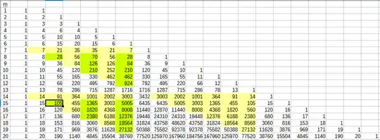

I created a program that outputs the first 35 rows of the triangle and highlights numbers that are divisible by 7.

Including the row number 33 in that diagram, I can see that there are 10 triangles there, which have $21 = T6$ ones. What I don't understand is how this helps getting the sum of all the numbers divisible by 7, because each triangle contains different numbers.

  • I agree with you - I don't see how it's easier either theoretically, I was simply explaining what I thought @HagenvonEitzen meant. I can however definitely be useful if you're going to use a computer to calculate this. Also, that's quite a nice table! I've done this before for a different purpose and I can tell you this behaves like a fractal. There's $7$ rows of the bigger triangles and then there's an even bigger triangle (starting in the $49$'th row). At every power of $7$, a new, bigger triangle occurs –  Apr 18 '17 at 10:11
