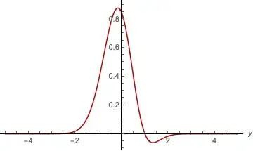

Is there a closed form for integrals such as
$\int_{-\infty }^{\infty } e^{-y^2} \text{erf}(1-y) \, dy$
The integrant seems simple enough?
