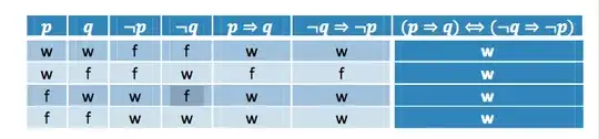

I have got this table as part of my study documents.
I try to understand but no chance.
I mean especially the third row.
If I invers p and q. So that p (which is the subset in my thinking) becomes true and q (which is the superset) becomes false: How can this be true?
Wouldn't it say then:
"It isn't in the superset (q == false) but it is in the subset (p)"?
Because implication from false to true becomes true implication the result is true.
But that doesn't make sense to me.
How can something be part of a subset but not part of the superset?
Can anybody help me to understand how this table works?
Respectively: What do I wrong concerning my thinking? Where's my error?
