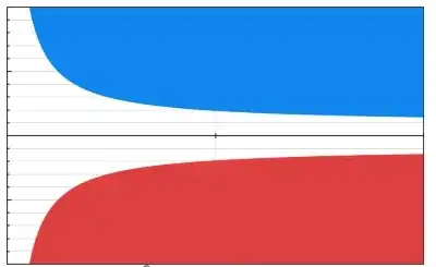

As stated by the thread you linked, $A,B$ closed is not a sufficient condition to proove your claim.
This is because the infimum distance may be realized only at infinity.
The counter example given by @gary can be adjusted for a non-zero distance:
It is easier to understand in $\mathbb R^2$
For instance take $A=\{ (x,y)\mid x\ge 0,y\ge 1+1/x\}$ [in blue]
and for $B$ its symetric with respect to axis $x$, i.e. $B=\{(x,y)\mid x\ge 0,y\le-1-1/x\}$. [in red]
They are respectively "asymptotic" to $y=1$ and $y=-1$ thus $d(A,B)=2$ but it is never reached within bounded area: you get $a_n\to(+\infty,1)$ and $b_n\to(+\infty,-1)$
So you have to use the condition that $B$ is also compact (or bounded which is equivalent in $\mathbb R^2$) so you can prevent the adjacent sequences $a_n,\ b_n$ to escape to infinity.
The proof by @Hagen von Eitzen shows the details.

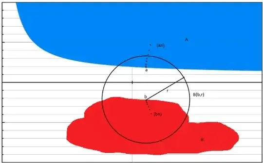

From the convergent subsequence $b_{\sigma(n)}\to b$ in $B$ compact, we can work locally in the disk of center $b$ and radius $r$ (large enough so it intersects $A$ but more importantly contains the convergent part of $(a_n)$), and this is in fact the toughest part of the proof, to show that we can prooceed like that.
This disk has notation $B(b,r)=\{x\mid |x-b|<r\}$ or $B_r(b)$ (B is initial for ball, b is center, r is radius), it is an open set. Since we need $A'$ closed, we have to take $\overline{B(b,r)}$ which mean the closure of this ball, i.e $\{x\mid |x-r|\le r\}$, also called the closed ball of center $b$ and radius $r$.
Thus $A'$ is intersection of two closed sets, so is closed, and also bounded, thus compact.
