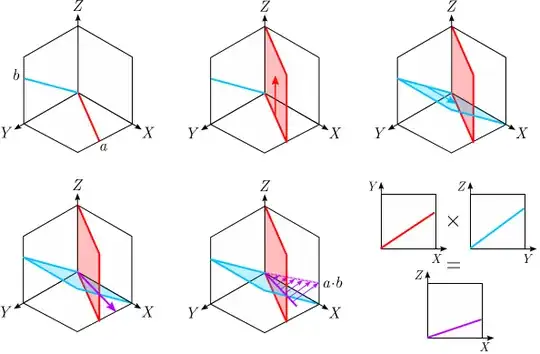

On a similar way, multiplication of projectively extended real numbers is just composition of the underlying linear relations, and can be computed geometrically by passing to $\mathbb{R}^3$. To construct $a\cdot b$, one first extends the line $a$ in XY perpendicularly to a plane, then does the same with the line $b$ in YZ, and finally projects the intersection of these two planes onto XZ to find the desired product:
Multiplication of two lines in RP1
This allows one to find, for example, a consistent meaning to the expression $0 \cdot \infty$ by including the elements of the two trivial Grassmannians $\bot \in \mathrm{Gr}(0, 2)$ and $\top \in \mathrm{Gr}(2, 2)$ among the possible outcomes of multiplication, as is pointed out here. In fact, the composition of any two functions or relations $\mathbb{R} \to \mathbb{R}$ can be performed in this way using their graphs in $\mathbb{R}^2$.

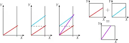

The first thing that came to my mind is to use an auxiliary vertical line at a nonzero distance from the origin:
Almost the addition of two lines in RP1
Unfortunately this approach breaks down for vertical lines. The definition of addition for linear relations given the link above seems to suggest a three-dimensional construction like in the case of multiplication, but I've failed to find something that works.

Draw a vertical line $\ell$ that meets both lines $a$ and $b$. (This is always possible: if one or both of the lines is vertical, use it.) Pick a point $p$ common to $a$ and $\ell$, and similarly a point $q$ common to $b$ and $\ell$. ($p$ is unique unless $a$ is vertical, in which case it is any point on $a$; the same goes for $q$ and $b$.) Construct a third point $r$ on $\ell$ whose $y$-coordinate is the sum of those of $p$ and $q$. The line passing through the origin and $r$ is $a+b$.
I've just found another construction that satisfies the given requirements. I know it comes one year late, but I'm posting it here as a supplementary solution just in case someone finds it interesting. The construction is based on the one for multiplication that I outlined in the question.
We work in $\mathbb{R}^4$, coordinatized by $(x,y,z,t)$. The starting configuration is a line $a$ in the plane XY and a line $b$ in the plane XZ (notice the slight difference with the case of multiplication; the shared axis here is the X axis).
To construct $a+b$, one extends the line $a$ perpendicularly to a hyperplane in $\mathbb{R}^4$, then does the same with the line $b$, then finds the triple intersection between these two hyperplanes and a third hyperplane given by the equation $y+z-t=0$. Finally, one projects this intersection onto the plane XT to find the desired sum.
It is straightforward to check, for example, that the lines with finite slope given by the equations $$a: \begin{cases} y=m_1 x\\ z=0\\ t=0\end{cases}$$ in the plane XY and $$b: \begin{cases} z=m_2 x\\ y=0\\ t=0\end{cases}$$ in the plane XZ correctly sum to the line $$a+b: \begin{cases} t=(m_1+m_2) x\\ y=0\\ z=0\end{cases}$$ in the plane XT. Similarly, the construction gives $\infty + a = a + \infty = \infty$ for any $a$ as required (including $\infty$).
This construction has the disadvantage that it can't be easily visualized like the others, since it requires four dimensions. However, it has the advantage of not requiring any arbitrary choices, and it still works if one replaces the lines with the graphs of arbitrary functions in $\mathbb{R}^2$. In that sense, it nicely supplements the accepted answer from Rahul.
