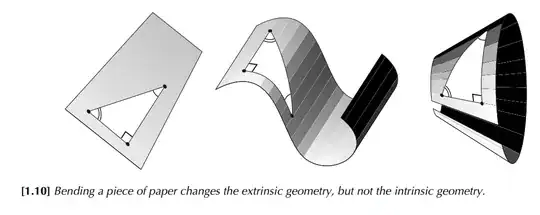

For anyone still trying to understand this intuitively, Tristan Needham's "Visual differential geometry and forms" here is an image and description from the book which helped me. Bending a piece of paper changes the extrinsic geometry, but not the intrinsic geometry
"Intrinsic geometry is unaltered when the surface is bent (as a piece of paper can be) into quite different shapes in space, as long as distances within the surface are not stretched or distorted in any way. Under such a bending, the so-called extrinsic geometry (how the surface sits in space) most certainly does change"
