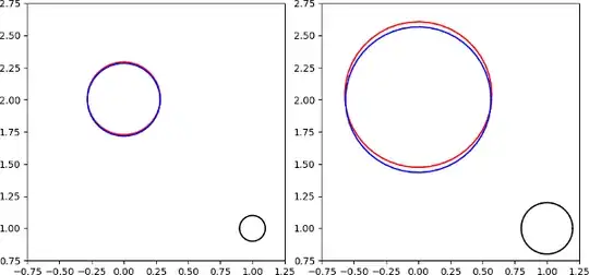

If $f\colon \mathbb C \to \mathbb C$ is complex-differentiable, then it is differentiable as an $\mathbb R^2 \to \mathbb R^2$ function, and it locally almost keeps angles and circles. To see this, look at one equivalent version of the complex-differentiability: $$f(z_0 + re^{it}) = f(z_0) + re^{it}f'(z_0) + \omicron(r), $$ where $z_0 \in \mathbb C, 0 \leq r, 0 \leq t \leq 2\pi$. In fact, as a demonstration have a picture of the image of two circles around $1 + i$ by $\operatorname{id_{\mathbb C}}^2$.
The black,$\{z_0 + re^{it} \mid t \in [0,2\pi]\}$ ones are our original circles ,
the reds, $\,\,\color{red}{f(\{z_0 + re^{it} \mid t \in [0,2\pi]\})}$ are the blacks' images by $f$, and
the blues, $\color{blue}{\{f(z_0) + re^{it}f'(z_0) \mid t \in [0,2\pi] \}}$ are the first order approximation of the red ones.
If we pick $z_0 = 1 + i, r=0.1$ and $0.2$, then we get, in order: r=0.1, r=0.2
As you can see in the $r=0.1$ case the red and blue circles are almost equal. As $r \to 0$, the difference becomes smaller and smaller. That's what I meant by locally almost keeping circles.

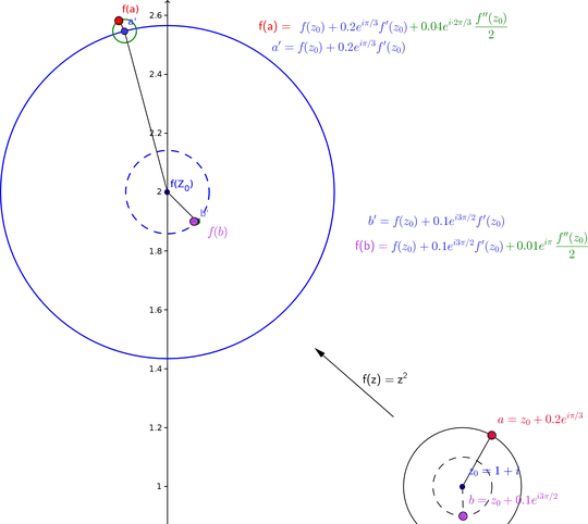

Here's another picture, displaying the image of a point from each of the two black circles. The black and blue circles represent the same as before, the green circles are due to the $\omicron(r)$ part.
Look for the points $\color{red}{a}, \color{blue}{a'}, \color{red}{f(a)}$ and $\color{purple}{b},\color{blue}{b'}, \color{purple}{f(b)}$. In fact, in the $r=0.1$ case the green circle is so small, you can barely see any of it (this is why the red and blue circles from a moment ago were almost equal).
As you can see, the image of a circle is essentially the sum of multiple circles, in this case, two; however, if $f$ has lots of non-zero derivatives, then there'll be lots of circles, and each "new" circle will have smaller radius, but higher frequency than the previous one (assuming $r < 1$).
