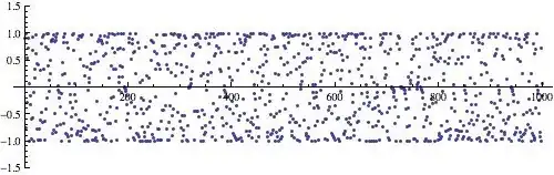

But then I thought about the sequence where $a_n = \sin(2^n)$, which looks like this for the first 1000 terms.
This sequence has no repeating terms, or else $\pi$ is rational. However I do not think every real number in $[0,1]$ appears in this sequence, as then the reals are countable, an absurd conclusion. It would not surprise me if this sequence has limit points, but how many? I do not immediately see any reason why $\sin(2^n)\notin (r-\epsilon,r+\epsilon)\subset[0,1]$, for $n$ large enough, because $r$ is arbitrary. This seems to imply that this sequence could have every point in $[0,1]\subset \mathbb R$ as a limit point, which slightly frightens me. So,
