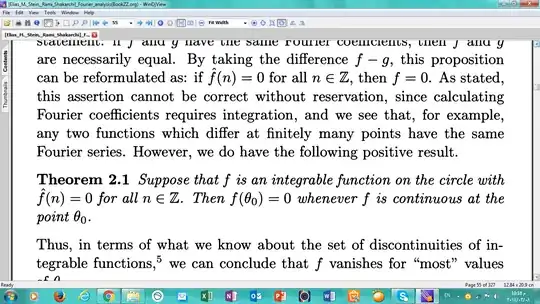

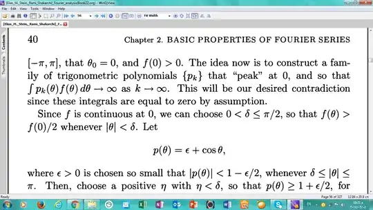

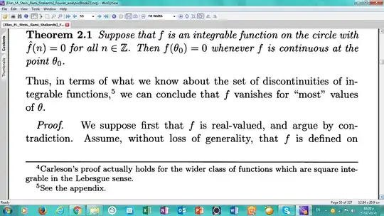

Could anyone explain the contradiction that he will use to prove the theorem?
Especially when he said that:" the idea now is to construct a family of trigonometric functions ${p_{k}}$ that peaks at 0, and so that $$\int p_{k}( \theta) f(\theta) d\theta \rightarrow \infty as\ k\ \rightarrow \infty.$$ This will be our contradiction, since those integrals tends to zero by assumption."
I do not see what is the assumption that makes them tends to zero and why the integral above tends to $\infty.$
Thanks. they are attached in the following photos.
the theorem the proof part 1 the proof part 2
