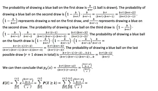

Here's the question: "An urn contains b blue balls and r red balls. You repeatedly and independently remove balls from urn (without returning them) until the first blue ball is drawn. All balls currently in the urn have an equal probability of being selected each time a ball is removed. Define the random variable X as the number of balls that are drawn (number of red balls that are removed plus the first blue ball that is removed). Find E[X], the expected value of random variable X."
I'm having trouble finding a closed form expression for the expected value. Here's the work I've done:
Here's the work I've done so far

  • I updated the question and added my current work. – LeBron James Mar 04 '17 at 01:14

  • How do you solve this problem without using the symmetry argument, but with the argument I have used in my work? – LeBron James Mar 04 '17 at 02:10
  • Can you solve the problem using algebra and probabilities instead of symmetry/intuition arguments? Look at the work I've done. – LeBron James Mar 04 '17 at 02:14
  • Well, I wouldn't. I don't even see a quick way to solve the recursion I wrote down (though surely there must be one). Manipulating identities between all the binomial coefficients may well be possible, but likely to be hard (and the proofs of those identities will likely involve symmetry). But the recursive argument (effectively proof by induction on $r$) is purely algebraic. – lulu Mar 04 '17 at 02:15
  • Can you walk through how to do this algebraically with summations? Please look at the work I've posted. In addition, we should use these identities to help arrive at the answer: http://i.imgur.com/4amu4EU.png, http://i.imgur.com/ICLFw4N.png – LeBron James Mar 04 '17 at 02:18
  • That's just the definition of the Expected Value. Of course the recursion uses the definition. – lulu Mar 04 '17 at 02:19
  • Can we do it algebraically without using recursion? – LeBron James Mar 04 '17 at 02:20
  • I'm not going to try to manipulate the sums. Now that you have the closed formula, though, perhaps that will guide you towards the right steps. Whether you use the recursion or not, the idea of proving the formula by induction on $r$ ought to work. – lulu Mar 04 '17 at 02:21
