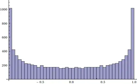

By Weyl's equidistribution theorem, the sequence $\{e^{in}\}_{n\geq 1}$ is uniformly distributed over the unit circle, by the irrationality of $\pi$. The distribution of $\sin(n)$ over $(-1,1)$ is so the same as the distribution of $\sin(X)$, where $X$ is a random variable uniformly distributed over $(0,2\pi)$.
The PDF of such distribution is so given by $\frac{1}{\pi\sqrt{1-t^2}}$, supported on $(-1,1)$.
Here it is a histogram representing the distribution of $\sin(n)$ for $n\in[1,10^4]$:
$\hspace{2cm}$enter image description here
