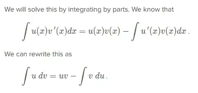

Example: integrate: x dx + 5. I used to think that the integration symbol is like an opening parenthesis and the d symbol is like the closing parenthesis, telling us that we don't want to integrate the + 5. I used to think that the x in dx determines the variable that we integrate by. Now take a look at the left hand side of this equation from Khan Academy:
Instead of integrating u(x)v'(x) by x, we integrate u by v. How are these things equal? How can we even integrate by v when it isn't a variable, it's a function! u doesn't necessarily even contain v, so how can we integrate u by v? What kind of black magic happened here?

As a first step, note that if $y = \sin(x)$, then $dy = \cos(x)\cdot dx$.
You can turn this back into a derivative by dividing both sides by dx. This is arguably not allowed, but for the sake of explanation, just realize that the statements: $$dy = \cos(x)\cdot dx$$ and $$\frac{dy}{dx}=\cos(x)$$ are saying the same thing.
Except, in the second statement, I specifically took the derivative of $x$ by applying $\frac{d}{dx}$ to both sides. In the first statement, I instead took the general derivative in terms of no variable by applying $d$ to both sides. When I do this, the chain rule takes differentials of each variable outside of each term.
So, what happens to $dv$ with the advance knowledge that $v$ is a function of $x$? Let's pretend that $v$ is $\sin(x)$ as above. I take the derivative of $v$, and take a $dx$ out from by chain rule. I hope that's enough to show that $dv=v'(x)dx$.

  • Plus, as you learn integration by parts, you won't think of the way the definition is written, you just start to do "Take the integral of one term, derivative of the other. If I can integrate that result, then tack on the uv - and continue" – Kaynex Feb 17 '17 at 16:33
