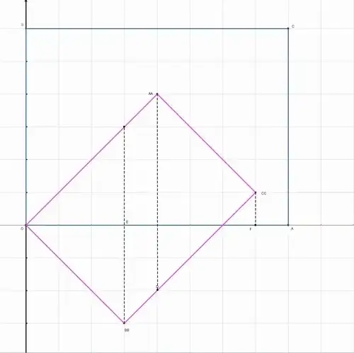

So let's have a look at the shape, $\mathcal D_0$ transforms into (obviously this will be some kind of rotated rectangle with change of orientation).
$\begin{cases} (x,y)=(0,0)\to(u,v)=(0,0)\\ (x,y)=(X,0)\to(u,v)=(\frac{X}{2},\frac{X}{2})\\ (x,y)=(0,Y)\to(u,v)=(\frac{Y}{2},-\frac{Y}{2})\\ (x,y)=(X,Y)\to(u,v)=(\frac{X+Y}{2},\frac{X-Y}{2})\\ \end{cases}$
We can see (as expected), that it is not an $[0,U]\times[0,V]$ for any $U,V$.
Since the integral is symmetric in $x,y$ we do not lose generality in assuming $0\le Y\le X$ (else invert the role of $x$ and $y$), so we can have a drawing to support the study.
As you can see the blue rectangle $\mathcal D_0$ is transformed into the pink rectangle $\mathcal R$, but it is not supported by horizontal and vertical axis any more.
Yet, let now split along the dash lines:
$\mathcal R$ can be decomposed into $3$ compliant domains $\begin{cases} u\in[0,\frac{Y}{2}] & v\in[-u,u]\\\\ u\in[\frac{Y}{2},\frac{X}{2}] & v\in[u-Y,u]\\\\ u\in[\frac{X}{2},\frac{X+Y}{2}] & v\in[u-Y,X-u]\\ \end{cases}$
