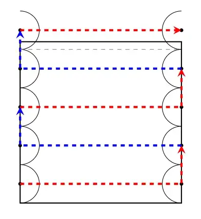

Thank you @jkff for an interesting question. Without claiming to provide full answer, it seems that the optimal path (shortest walk for the ranger) is the one that does not cover any area twice. There is probably many of those. One straightforward example is drawn below. The length of the path is $\lfloor\frac{S}{R}\rfloor(S+R)+S$. Each component (highlighted by alternating red and blue) has length $S+R$ and there is $\lfloor\frac{S}{R}\rfloor$ of those. The last component covers the remaining part of the forest.
Jan
  • 3,637
  • Yes, this is a reasonable requirement (do not cover any area twice), but I'm not sure that this particular path is optimal in that sense. More precisely: we would like to maximize the additional area covered by each additional elementary segment of the curve; the long straight lines are clearly optimal in that sense - but the vertical lines, might be not so much. – jkff Feb 03 '17 at 18:59
  • @jkff I agree that the vertical elements have sense of sub-optimality. Let me also observe that, despite the fact that I used that term myself, it is not really clear one would define 'do not over any area twice', since when the ranger moves, he is constantly doing that. – Jan Feb 03 '17 at 19:01
