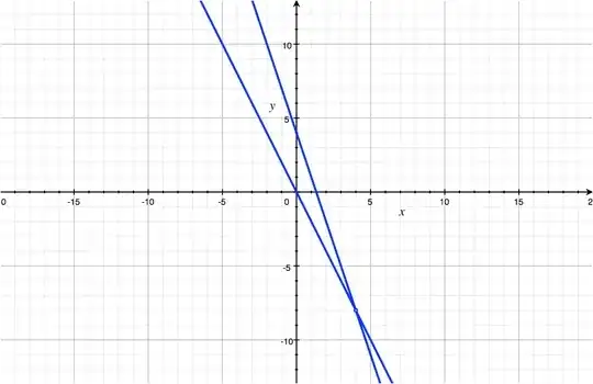

We start with equations $2x+y=0$ and $3x+y=4$, which define the two lines depicted below

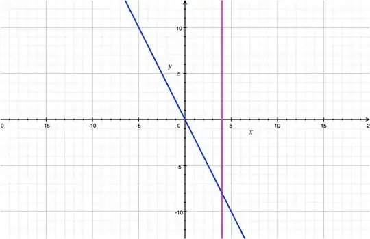

Subtracting $2x+y=0$ from $3x+y=4$, we obtain $x=4$, which defines a line parallel to the $y$-axis

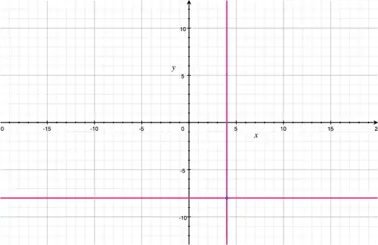

Subtracting $x = 4$ twice from the equation $2x+y=0$, we obtain $y=-8$, which does define a line parallel to the $x$-axis
Note that all $4$ of these lines pass through the point $(4,-8)$.
