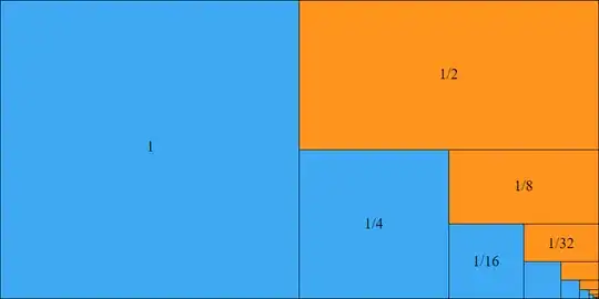

Clearly, your sum will be $2$ minus a small square or rectangle in the corner.
