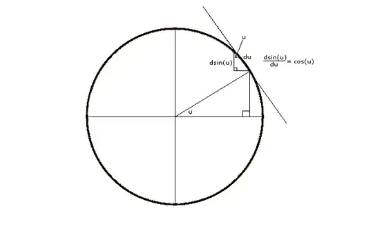

Is this the correct way to make this visualization of the derivative of sine more... rigorous? At least, for $u\in(0,\pi/2)$.
Borrowed from Proofs without words. To try to make this rigorous, I argued that when $u\pm\Delta u$ is in the first quadrant, that we have the following geometrically obtained bounds:
$$\frac{\sin(u+\Delta u)-\sin(u)}{\Delta u}<\cos(u)<\frac{\sin(u-\Delta u)-\sin(u)}{-\Delta u}$$
where $\Delta u>0$. From this, I thought that the derivative of sine comes trivially, though I am wondering if this could be more rigorous.
