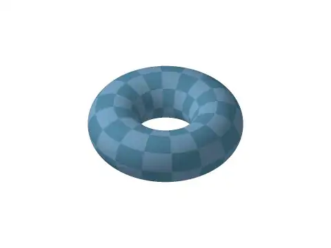

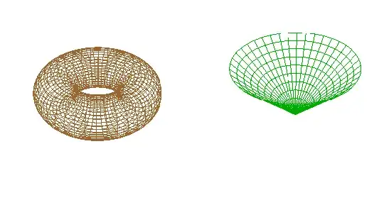

  • This question has to do with specific Riemannian structures on the cone and torus. "Lines of curvature" refers to the geometry of surfaces - they are the eigenvectors of the Gaussian curvature.
  • The lines of curvature are exactly the ones you'd think of:
    • For the torus they are the equatorial and meridian slices
    • For the cone, you can slide along a vertical plane through the axis of symmetry and get the "rulings" or along a horizontal plane and get circles. enter image description here
  • These days results 5 and 6 are standard properties in conformal geometry

It's easier to work with a cone, it's a scaled up circle. The circle is $[\sin(x),\cos(y),1]$, scale that up by $\sin(y)$ and you have a cone. $[\sin(x)\sin(y), \cos(x)\sin(y), \sin(y)]$. If you use a function to determine color and relate it to area, you get a very pretty cone, anyway I'll get back to that. Now it seems to me the cones use 2d angles. If you were to take those side lengths and put them inside a semi circle, the diameter would always be 1. A sphere is in 3d. If you took the three side lengths and put them in a circle, it would not fit in a semicircle of diameter $1$. You need to go up on a 90 degree angle into 3d space and you need to use the distance of the other two sides in order to do it. $$\sqrt{(\sin(x)\sin(y))^2+(\cos(x)\sin(y))}=\cos(y)$$
Do the same thing with this function $$[\sin(x)(1+(1/2)\sin(y)), \cos(x)(1+(1/2)\sin(y)), (1/2)\sin(y)]$$ It's a cone with the top chopped off. If you used color as a function of area, you would quickly realize everything is exactly where it should be. So you are using 2d angles, you need to go into 3d space, change the third coordiniate of $(1/2)\sin(y)$ into $(1/2)\cos(y))$.
