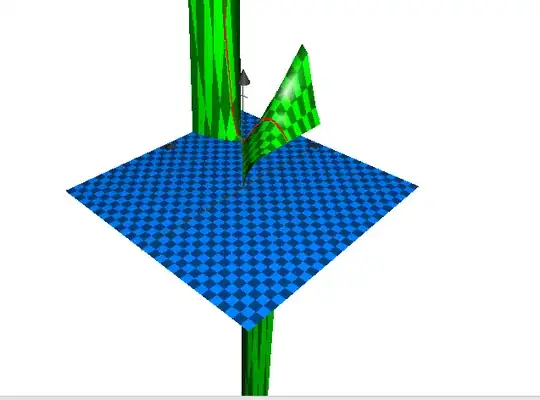

I don't intend this to be an outright answer, but simply a graphic to aid intuition. This is a 3D plot of the surface $z = x^y - y^x$. As noted we are only in the first quadrant since negative inputs yield not necessarily real $z$ values. We want to look at cross sections of the surface for fixed $x$ values and see which ones are always greater than 0. In this graphic the red curve is a parameterization of the cross section for $x = e$ and the blue plane is $z=0$. We see that the parameterized line at $x=e$ is the only one that will satisfy as moving left or right dips below the $z = 0$ plane.
Hope this visualization helps aid your intuition with more formal justifications!
