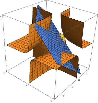

    $x+y+z=1$ is the equation of a plane through three points $( 1,0,0), (0,1,0), (0, 0,1)$. Consider surface $xyz=1$ and try to find whether it crosses the plane or not. – Widawensen Dec 21 '16 at 15:20

There are infinite solutions. $z=1-x-y$ is a plane's equation and $z=\dfrac{1}{xy}$ is a complicated curve, but their intersection presents infinitely many real points.
Intersection

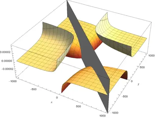

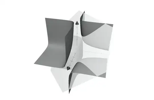

Those numbers are the intersection of the surface $x y z=1$ and the plane $x+y+z=1$. A quick plot of these surfaces shows that these surfaces do intersect and that the solution consist of a curve (so infinitely many solutions) that looks something like a three-way hyperbola.
plot of surfaces

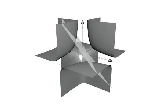

Using Grapher, a few more plots (for $r=1$) to complement the other answers:
Consider the polynomial $$P(t)=(t-x)(t-y)(t-z)=t^3-t^2+pt-1$$ Where $p=xy+xz+yz$. The discriminant of the general cubic ($ax^3+bx^2+cx+d$) is $\Delta=b^2c^2-4ac^3-4b^3d-27a^2d^2+18abcd$, and $\Delta\geq 0$ if and only if all 3 roots are real. The discriminant of $P(t)$ is $\Delta=-4p^3+p^2+18p-31$. Solving the inequality $\Delta\geq 0$ you get $$p\leq\frac{1}{12}\left(1-\frac{217}{\sqrt[3]{6371-624\sqrt{78}}}-\sqrt[3]{6371-624\sqrt{78}}\right)\approx -2.6107$$ So whenever that inequality is satisfied the roots of $t^3-t^2+pt-1$ are real and their sum and product is 1.

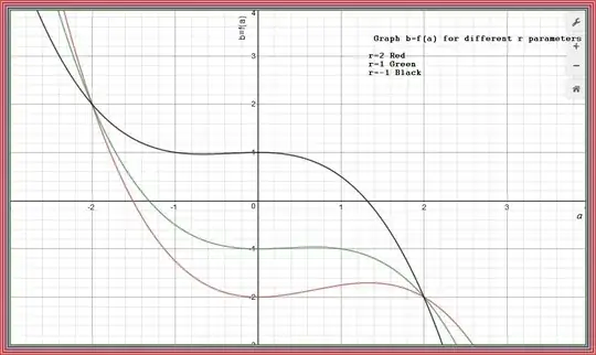

General case: $r$ being an arbitrary real number.
The point $(r,0,0)$ belongs to the plane $x+y+z=r$.
The point $(x,y,z)=((r-a), \dfrac{a}{2} , \dfrac{a}{2} )$ also belongs to this plane because $(r-a)+ \dfrac{a}{2}+ \dfrac{a}{2}=r$.
  • Consider function $b=f(a)= (r-a) \dfrac{a}{2} \dfrac{a}{2}-r $.
    This is a continuous cubic function with the parameter $r$ so it has values from $+\infty$ to $-\infty$ and it is assured that this function crosses line $b=0$ so we have at least one real solution $a_1$ for the equation $(r-a) \dfrac{a}{2} \dfrac{a}{2} =xyz=r$
  • Therefore real solution for the set of equations in the question always exists .
See picture below for some cases of $r$
Widawensen
  • 8,517
  • In fact the system of equations $x+y+z=r_1$ and $xyz=r_2$ has always real solution even if $r_1\neq{r_2}$. There is no way for the plane described by the first equation to miss surfaces described by the second one. – Widawensen Dec 22 '16 at 18:02
  • The choice of a function $b=f(a)$ is equivalent to the choice of a line from the plane $x+y+z=r$. Other constructed function give other solution for the equation $xyz=r$, so this method after transformation of the equation $xyz=r$ into a cubic one give also a way of finding solutions for this set of equations with the known methods of solving cubic equations (see en.wikipedia.org/wiki/Cubic_function). The crucial here is that the coefficient standing by $a^3$ is never equal $0$ so the equation is cubic and it has always at least one real solution (sometimes there are three solutions) – Widawensen Dec 23 '16 at 08:50

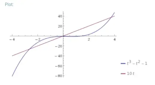

Another approach: as already noted in other answers, in view of Viète's formulas, you are asking whether there exists $a\in\mathbb{R}$ such that $t^3-t^2+at-1=0$ has three real solutions.
Equivalently, you are asking whether there is an $a$ such that the graphs of $y=t^3-t^2-1$ and $y=at$ intersect in three points. Equivalently, you are asking whether there is a line through the origin that intersects the graph of the cubic $y=t^3-t^2-1$ in at least two points.
If you plot this curve it's not complicated to find one graphically, for instance use plot t^3-t^2-1 and 10t in [-4,4] in Wolfram Alpha:
