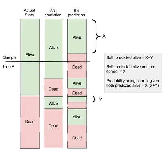

I always find it useful to visualise these quantities and relationships. I created the following graphic to visualise the whole event space. The three "columns" in this graphic denote the different simple/individual events that can happen: 1) the cat actually being dead or alive, 2) A's prediction that the cat is dead or alive, and 3) B's prediction that the cat is dead or alive. To sample the space you simply take a horizontal line across the columns. For example, line $E$ drawn in the graphic, shows the combination of events where: 1) the cat is alive, 2) witch $A$ predicted alive, and 3) witch $B$ predicted dead. The tricky part is drawing the columns in such a way so that they reflect the independences and correlations between the simple events. For example B predicting true does not depend on A's prediction. Can you see how this is reflected in the drawing? Or note that A's and B's predictions depend on whether the cat is actually alive or dead (linked to their prediction accuracies). Once we have the graphic we can easily visualise the solution. In the graphic, I made the priors not equal (just to stress the importance of their knowledge), I made A's accuracy (= sensitivity = specificity) around $75\%$ and B's accuracy (= sensitivity = specificity) around $55\%$. We can see how the result derived by Bayes rule is the same as the one derived graphically.
Cat dead or alive probability space
I hope this is useful.

  • When you say $P(L|A_L)$ depends on $P(L)$, do you mean that since $P(L|A_L)\le P(L)$, therefore it cannot act as an accuracy, because accuracy could be any value from 0 to 1 – fizis Dec 23 '16 at 02:09
  • I understood, the prediction of witches should not affect the probability of that cat is dead or alive, therefore $P(L|A_L)=P(L)$. – fizis Dec 23 '16 at 02:19
  • I am sorry that I haven't select your answer before the bounty expires, this is a good answer, although I am still reading it. – fizis Dec 23 '16 at 02:22
  • @fizis No I just mean that $P(L|A_L)$ depends on $P(L)$. Note that $P(A_L|L)$ does not depend on $P(L)$. Also it is not true that $P(L|A_L)\le P(L)$, I am not sure how you derived that. – Thanassis Dec 23 '16 at 02:22
  • @fizis, that's ok, don't worry about the bounty. I'l be very happy if it provides more clarity for you. I'll be here to answer more questions. Or maybe a chat room will be more appropriate (when I figure out how to set it up). – Thanassis Dec 23 '16 at 02:25
  • In fact, this is what you have assumed (maybe without realising) in your first solution.
    About my first solution, most people will say that this is from considering sample space. However the implicit information needed is that the cat dead or alive need to have the same prior. Other wise, different prior will lead to a different sample space.
    – fizis Dec 23 '16 at 02:33
  • @fizis, you do not need to have the same prior but you have to assume some prior (1/2 being the most natural/neutral perhaps). In the graphic I created for example (which can be seen as "considering the sample space") I have taken non-equal priors, so I can highlight their importance and influence. – Thanassis Dec 23 '16 at 02:38
    The graph is very intuitive, very good illustration. – fizis Dec 23 '16 at 06:46
